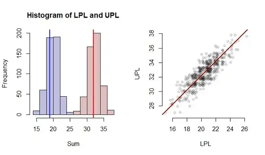

Here are some illustrations. The data consist of all eight possible combinations of $A$, $B$, and $C$ (binary coded), each repeated 24 times for a total of 192 observations. The true model is that the logit of the response equals $A-C$. Indeed, the coefficients of $A$ and $C$ are significant in the actual data while the other two coefficients (intercept and $B$) are not. For each of $500$ bootstrap iterations, $200$ sums-of-responses were obtained in order to estimate a $95\%$ two-sided prediction interval $(\text{LPL},\text{UPL}]$. The correct prediction interval, based on the true model, is $(18, 31]$.
Figure
The histograms show the marginal distributions of the prediction limits: LPL in blue, UPL in red. The correct limits of $18$ and $31$ are marked by vertical colored lines. The scatterplot indicates the bivariate relationship of the prediction limits. The mean width $\text{UPL}-\text{LPL}$ is $12.2$, plotted as the dark red line.
The agreement of these results with the true values is encouraging. Iteration of this short experiment (using varying random number seeds) provides some intuition about how much can be expected from a dataset like this. Change the datasets to study any other situation in the same manner.
