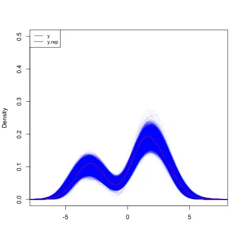

Results
The MCMC predictions are bimodal as intended

Edit: Results using Stan
I added some code for a similar model using Stan in case that is useful. Here's the same plot using the Stan model:

y.rep.stan <- extract(stan.fit)$y_rep
png(file="postpreds_stan.png")
plot(density(y.obs), xlab="", col="red", ylim=c(0, 0.5), main="", type='n')
for(b in 1:nrow(y.rep.stan)) {
    lines(density(y.rep.stan[b,]), col=rgb(0, 0, 1, 0.1))
lines(density(y.obs), xlab="", col="red", ylim=c(0, 0.5))
legend("topleft", c("y", "y.rep.stan"), col=c("red", "blue"), lty=1, cex=0.8)
dev.off()
