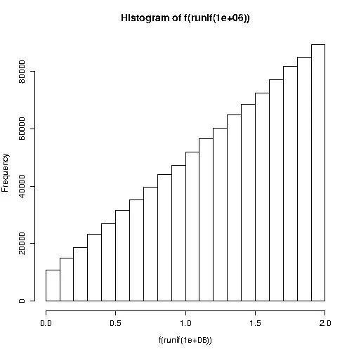

From this it is easy to see that if $\tan \phi > 0$, the portion of parabola in which we are interested is a part of the right side of the parabola, and the root to keep is the highest of the two roots, that is $$ x = {1\over \tan \phi} \left( {B\over 2} \tan \phi - {1\over B} + \sqrt{ \left( {B\over 2} \tan \phi - {1\over B} \right)^2 + 2 \tan \phi \cdot t}. \right)$$ To the contrary, if $\tan\phi < 0$, the parabola is upside down, and we are interest in its left part. The root to keep is the lowest one. Taking into account the sign of $\tan\phi$ it appears that this is the same root (ie the one with $+\sqrt\Delta$) than in the first case.
Here is some R code.
phi <- pi/8; B <- 2
f <- function(t) (-(1/B - 0.5*B*tan(phi)) +
       sqrt( (1/B - 0.5*B*tan(phi))**2 + 2 * tan(phi) * t))/tan(phi)
hist(f(runif(1e6)))
histogramm 1

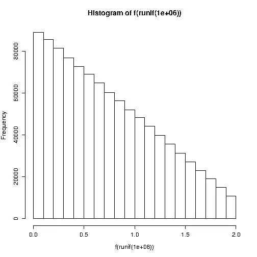

And with $\phi < 0$:
phi <- -pi/8
hist(f(runif(1e6)))
