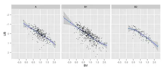

OK, I've extensively revised this answer. I think rather than binning your data and comparing counts in each bin, the suggestion I'd buried in my original answer of fitting a 2d kernel density estimate and comparing them is a much better idea. Even better, there is a function kde.test() in Tarn Duong's ks package for R that does this easy as pie.
Check the documentation for kde.test for more details and the arguments you can tweak. But basically it does pretty much exactly what you want. The p value it returns is the probability of generating the two sets of data you are comparing under the null hypothesis that they were being generated from the same distribution . So the higher the p-value, the better the fit between A and B. See my example below where this easily picks up that B1 and A are different, but that B2 and A are plausibly the same (which is how they were generated).
# generate some data that at least looks a bit similar
generate <- function(n, displ=1, perturb=1){
    BV <- rnorm(n, 1*displ, 0.4*perturb)
    UB <- -2*displ + BV + exp(rnorm(n,0,.3*perturb))
    data.frame(BV, UB)
set.seed(100)
A <- generate(300)
B1 <- generate(500, 0.9, 1.2)
B2 <- generate(100, 1, 1)
AandB <- rbind(A,B1, B2)
AandB$type <- rep(c("A", "B1", "B2"), c(300,500,100))
# plot
p <- ggplot(AandB, aes(x=BV, y=UB)) + facet_grid(~type) +
    geom_smooth() +     scale_y_reverse() + theme_grey(9)
win.graph(7,3)
p +geom_point(size=.7)
> library(ks)
> kde.test(x1=as.matrix(A), x2=as.matrix(B1))$pvalue
[1] 2.213532e-05
> kde.test(x1=as.matrix(A), x2=as.matrix(B2))$pvalue
[1] 0.5769637
