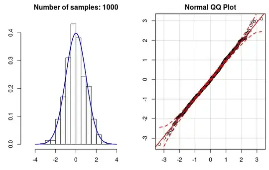

Next, below is a modified example taken from Veranzi (https://cran.r-project.org/doc/contrib/Verzani-SimpleR.pdf, page 51).
The example works to illustrate how $\frac{\bar{X} - \mu}{\sigma/ \sqrt{n}} \sim N(0, 1)$ for skewed data. In the example, $\sigma$ is estimated from the data, as opposed to being known apriori.
Example: CLT with exponential data
Let’s do one more example. Suppose we start with a skewed distribution, the central limit theorem says that the average will eventually look normal. That is, it is approximately normal for large n. What does “eventually” mean? What does “large” mean? We can get an idea through simulation.
f = function(n=100,mu=10) (mean(rexp(n,1/mu))-mu)/(mu/sqrt(n))
iters = c(5, 10, 20, 100)  ## sample sizes
par(mfrow = c(2,2), mar = c(2,2,2,2))
for(i in iters){
  s <- replicate(n = 1000, expr = f(n = i), simplify = TRUE)
  hist(x = s, breaks = "Scott", probability = TRUE,
       main = paste("Number of samples: ", i), xlab = "mean", ylab = "probability",
       xlim = c(-5, 5), ylim = c(0, 0.45))
  curve(dnorm(x, mean = 0, sd = 1) ,from =  -4, to = 4 , add=T, col='blue',lwd=2)
library(car)
dev.off()
s <- replicate(n = 1000, expr = f(n = 10^3), simplify = TRUE)
     main = "Number of samples: 1000", xlab = "mean", ylab = "probability",
car::qq.plot(s, main = "Normal QQ Plot")
First, data is being generated from a an exponential distribution with rate 0.1, at samples of 5, 10, 20, 100 and 1000. The first four graphs show how the scaled means progress to looking more normal-ish as sample size is increased for each scaled mean (or t-stat) calculation. enter image description here
Finally, at 1000 samples, the histogram appears settled.
