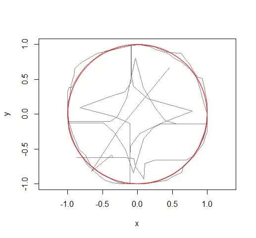

Finally, I tried R's DBA implementation in some of my training sets and found an unpleasant result when dealing with repetitive circular trajectories of different lengths and speed (next image).
Last questions: Is there some theoretical consideration I should bare in mind when averaging such time series? What are the recommended preprocessing techniques when dealing with time series?
Averaging of spins with DBA
I know the questions asked are a bit different from each other, but they cover the same topic so I thought they were better together.
Below, I post the code to reproduce the image. The example included in the code consists of 25 time series of different lengths, with a different starting point and a different advancing speed. Think of it as cars racing on a circuit track, the cars are tracked from a random starting point and they are monitored until they finish the race. I calculate the average time series using the DBA function. The problem I find is that the average (plotted in black) does not respect the circular nature of the track and the races performed by the cars (red lines). Note that this is just a particular case, the trajectories I want to track are slightly more complex and, hence, I am more interested in the theory of the field rather than solving this particular example (which I believe can be solved by switching to polar coordinates).
