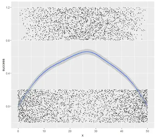

For example, the default method = 'gam' smoothing in ggplot2 seems to reproduce the inverse quadratic relationship pretty well, and seems to be quite well calibrated:
ggplot(tmp_df[tmp_df$keep == 1, ], aes(x = x, y = success)) +
    geom_point(position = position_jitter(width = 0.2, height = 0.2), size = 0.1) +
    geom_smooth()
It seems to work quite well even if due to bad experimental design I did not sample the time space uniformly:
ggplot(tmp_df, aes(x = x, y = success)) +
    geom_smooth()
But, one issue already is that the confidence interval near $x = 0$ and $x = 50$ goes into the negative y-axis.

You should fit a binomial GAM:
library(mgcv)
fit <- gam(success ~ s(x), data = tmp_df, family = binomial)
tmp_df <- cbind(tmp_df, predict(fit, se.fit = TRUE))
tmp_df$lwr <- tmp_df$fit - 2 * tmp_df$se.fit
tmp_df$upr <- tmp_df$fit + 2 * tmp_df$se.fit
library(boot)
tmp_df$fit <- inv.logit(tmp_df$fit)
tmp_df$lwr <- inv.logit(tmp_df$lwr)
tmp_df$upr <- inv.logit(tmp_df$upr)
  geom_line(aes(y = fit), col = "blue") +
  geom_ribbon(aes(ymin = lwr, ymax = upr), alpha = 0.2)
resulting plot
