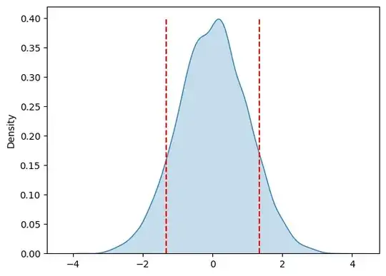

We can visualize this with a small code example in Python:

ys = np.random.normal(size = 10000) h = 0.5np.log(2np.pinp.exp(1)) side_length = 2*h
sns.kdeplot(ys, fill = True) plt.vlines(x = side_length/2, ymin = 0, ymax = 0.4, color = 'red', linestyles = 'dashed') plt.vlines(x = -side_length/2, ymin = 0, ymax = 0.4, color = 'red', linestyles = 'dashed')
This side length captures a large portion of the probability mass in this distribution: Equivalent side length for the standard normal distribution
The interval between the red lines is $2^h$. As in this case $n$ is only 1 (and the Theorem above requires $n$ to be large), we can clearly see that the entropy is not exactly the equivalent side length of the volume that captures almost all probability mass.
