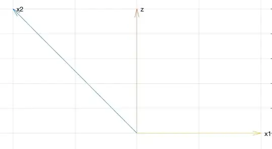

Another simple example:
  • Let $z \sim \mathcal{N}(0,1)$
  • Let $x_1 \sim \mathcal{N}(0,1)$
  • Let $x_2 = z - x_1$ (hence $z = x_1 + x_2$)
Then:
  • $\mathrm{Corr}(z, x_1) = 0$
  • $\mathrm{Corr}(z, x_2) \approx .7$
  • $\mathrm{Corr}(z, x_1 + x_2) = 1$
Geometrically, what's going on is like in WHuber's graphic. Conceptually, it might look something like this: enter image description here
(At some point in your math career, it can be enlightening to learn that random variables are vectors, $E[XY]$ is an inner product, and hence correlation is the cosine of the angle between the two random variables.)
$x_1$ and $z$ are uncorrelated, hence they're orthogonal. Let $\theta$ denote the angle between two vectors.
  • $\mathrm{Corr}(z, x_1) = \cos \theta_{zx_1} = 0 \quad \quad \theta_{z,x_1} = \frac{\pi}{2}$
  • $\mathrm{Corr}(z, x_2) = \cos \theta_{zx_2} \approx .7 \quad \quad \theta_{z,x_2} = \frac{\pi}{4} $
  • $\mathrm{Corr}(z, x_1 + x_2) = \cos \theta_{z,x_1+x_2} = 1 \quad \quad \theta_{z, x_1 + x_2} = 0$
To connect to the discussion in the comments Flounderer's answer, think of $z$ as some signal, $-x_1$ as some noise, and noisy signal $x_2$ as the sum of signal $z$ and noise $-x_1$. Adding $x_1$ to $x_2$ is equivalent to subtracting noise $-x_1$ from the noisy signal $x_2$.

  • Please explain the premises of your answer. After positing z = x1 + x2, why say “then Corr(z,x1)=0”? Are you saying that Corr(z,x1)=0 follows from your first Let statement, or is the correlation of zero an additional assumption? If it is an additional assumption, why does the situation in the original question require that additional assumption? – Joel W. Jan 20 '17 at 17:02
  • @JoelW. I'm saying $z$ is a random variable following the standard normal distribution and $x_1$ is an independent random variable that also follows the standard normal distribution. $z$ and $x_1$ are independent, hence their correlation is precisely 0. Then compute $z - x_1$ and call that $x_2$. – Matthew Gunn Jan 20 '17 at 17:05
  • @MatthewGunn. Your third Let says z=x1+x2. That seems to violate your first two Lets that say that z and x1 are independent. – Joel W. Jan 20 '17 at 17:23
  • @JoelW. it does not! Do you agree I can define $x_2$ using $x_2 = z - x_1$? (you should.) Then by basic algebra, it follows that $x_1 + x_2 = z$ (add $x_1$ to both sides). – Matthew Gunn Jan 20 '17 at 17:52
    @MatthewGunn When you say x2 = z − x1, it seems so clear that you do not imply any relationship between z and x1. But when you say the same thing in a different form, z=x1+x2, it seems you are saying that z and x1 are not independent. I find that confusing. Can you help me wrap my head around this? – Joel W. Jan 20 '17 at 18:31
  • @JoelW. You seem to have some intuition that you can only add or subtract unrelated random variables.This is not the case! Let $z$ denote the roll of a six sided die. Let $x_1$ be the result of rolling another six sided die. Now let's define $x_2$ as the difference between the first roll $z$ and the second roll $x_1$, that is, $x_2 = z - x_1$. To write out all the possible outcomes: $\begin{array} zz&x_1&x_2\1&1&0\1&2&-1\1&3&-2\1&4&-3\1&5&-4\1 &6&-5\2&1&1\2&2&0\2&3&-1\2&4&-2\2&5&-3\2&6&-4\3&1&2\3&2 & 1\ \ldots \end{array}$ – Matthew Gunn Jan 20 '17 at 20:35
  • @JoelW Possibly another thing that may be helpful $\mathrm{Cov}(x_1 + x_2, x_1) = \mathrm{Cov}(x_1, x_1) + \mathrm{Cov}(x_1, x_2) = \mathrm{Var}(x_1) + \mathrm{Cov}(x_1, x_2)$. if $\mathrm{Var}(x_1) = - \mathrm{Cov}(x_1, x_2)$ then $\mathrm{Cov}(x_1 + x_2, x_1) = 0$.
    When you see $x_1 + x_2$, you may have some instinct that $x_1$ and $x_2$ are uncorrelated (if $\mathrm{Corr}(x_1, x_2) = 0$, then of course $\mathrm{Corr}(x_1, x_1 + x_2) > 0$). But your instinct that $\mathrm{Corr}(x_1,x_2) = 0$ whenever you see $x_1 + x_2$ is not correct so I'd try to get rid of that instinct...
    – Matthew Gunn Jan 20 '17 at 20:56
  • The dice are an interesting physical model, but I think the model has narrow generality. In general, if z = x1 + x2, then z and x1 are not independent. Do you agree? – Joel W. Jan 20 '17 at 21:19
    @JoelW. I do not agree because that statement is not true. Seeing $z = x_1 + x_2$ implies nothing about independence between $z$ and $x_1$. – Matthew Gunn Jan 20 '17 at 21:39
  • My misunderstanding might be a result of this being a discussion between a scientist and a mathematician. In my field, Y=ax + b. is the formula for predicting y from x. That led me to be confused when you wrote z=x1+x2. – Joel W. Jan 22 '17 at 03:04
