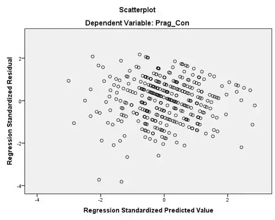

Adding diagnostic plots.....
Normal PP Plot Residuals vs Predicted

  • I have uploaded the normal pp plot and the residuals vs predicted plot. By added variable plots, I guess you mean partial regression plots that plot each of the IVs vs DV. I tried to upload them too. But, unfortunately, for lack of reputations I am only allowed to use 2 links in my post. – Vighnesh NV Jan 13 '17 at 17:08

  • You have clear lines in your residuals, suggesting they only come in discrete values. What is your dependent variable? – gung - Reinstate Monica Jan 13 '17 at 17:21
  • @gung That point was raised separately in the OP's earlier thread http://stats.stackexchange.com/questions/256005/apparent-correlation-between-standardized-residuals-and-predicted-in-regression This looks like a different response, but the principle's established. – Nick Cox Jan 13 '17 at 17:36
