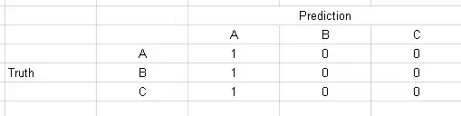

For example, if the confusion matrix is:
Then:
  • the accuracy is $~\frac{1 + 0+ 0}{1 +0 +0 +1 +0 +0 +1 +0 +0 }=~\frac{1}{3}$
  • the average Jaccard score is $~\frac{1}{3}\left(\frac{1}{1 + 0+ 0+1 +1} + \frac{0}{0+1 +0 +0 +0} + \frac{0}{0 +0 +1 +0 +0}\right) = \frac{1}{9}$

  • I would like to comment on the "multiclass Jaccard" you show - without claiming if it is good or bad (for I don't know); anyway it is very different approach from what I expressed in my answer as what I suppose the authors of the python package might have meant. In regard to your Jaccard: notice that each summand is a bona fide Jaccard between "true" and "prediction" seen as binary (2-class) variables. For example, in AA/(AA+AB+...) A is seen as the class and B&C are combined as the other class. You are thus averaging in the end three 2-class Jaccards. – ttnphns Jan 13 '17 at 23:10
  • (cont.) This is questionable because the classification is one multinomial, not three binomial. (It is akin doing 3 binary logistic regressions instead of one nominal logistic.) I'm not to say it is completely incorrect, only that it may raise objections. – ttnphns Jan 13 '17 at 23:10
  • P.S. I've chosen currently to downvote because of the considerations I've given above. I'll be glad to withdraw if the answer is supported with more arguments. – ttnphns Jan 16 '17 at 08:04
