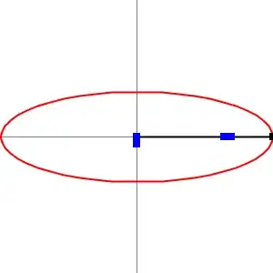

I will go for a purely geometric approach for a very specific scenario. Let us consider a discrete valued random variable $X$ taking values $\{x_1,x_2\}$ with probabilities $(p_1,p_2)$. We will further assume that this random variable can be represented in $\mathbb{R}^2$ as a vector, $\mathbf{X} = \left(x_1\sqrt{p_1},x_2\sqrt{p_2} \right)$. enter image description here
Notice that the length-square of $\mathbf{X}$ is $x_1^2p_1+x_2^2p_2$ which is equal to $E[X^2]$. Thus, $\left\| \mathbf{X} \right\| = \sqrt{E[X^2]}$.
Since $p_1+p_2=1$, the tip of vector $\mathbf{X}$ actually traces an ellipse. This becomes easier to see if one reparametrizes $p_1$ and $p_2$ as $\cos^2(\theta)$ and $\sin^2(\theta)$. Hence, we have $\sqrt{p_1} =\cos(\theta)$ and $\sqrt{p_2} = \sin(\theta)$.
One way of drawing ellipses is via a mechanism called Trammel of Archimedes. As described in wiki: It consists of two shuttles which are confined ("trammelled") to perpendicular channels or rails, and a rod which is attached to the shuttles by pivots at fixed positions along the rod. As the shuttles move back and forth, each along its channel, the end of the rod moves in an elliptical path. This principle is illustrated in the figure below.
Now let us geometrically analyze one instance of this trammel when the vertical shuttle is at $A$ and the horizontal shuttle is at $B$ forming an angle of $\theta$. Due to construction, $\left|BX\right| = x_2$ and $\left| AB \right| = x_1-x_2$, $\forall \theta$ (here $x_1\geq x_2$ is assumed wlog).
Let us draw a line from origin, $OC$, that is perpendicular to the rod. One can show that $\left| OC \right|=(x_1-x_2) \sin(\theta) \cos(\theta)$. For this specific random variable \begin{eqnarray} Var(X) &=& (x_1^2p_1 +x_2^2p_2) - (x_1p_1+x_2p_2)^2 \\ &=& x_1^2p_1 +x_2^2p_2 - x_1^2p_1^2 - x_2^2p_2^2 - 2x_1x_2p_1p_2 \\ &=& x_1^2(p_1-p_1^2) + x_2^2(p_2-p_2^2) - 2x_1x_2p_1p_2 \\ &=& p_1p_2(x_1^2- 2x_1x_2 + x_2^2) \\ &=& \left[(x_1-x_2)\sqrt{p_1}\sqrt{p_2}\right]^2 = \left|OC \right|^2 \end{eqnarray} Therefore, the perpendicular distance $\left|OC \right|$ from the origin to the rod is actually equal to the standard deviation, $\sigma$.
If we compute the length of segment from $C$ to $X$: \begin{eqnarray} \left|CX\right| &=& x_2 + (x_1-x_2)\cos^2(\theta) \\ &=& x_1\cos^2(\theta) +x_2\sin^2(\theta) \\ &=& x_1p_1 + x_2p_2 = E[X] \end{eqnarray}
Applying the Pythagorean Theorem in the triangle OCX, we end up with \begin{equation} E[X^2] = Var(X) + E[X]^2. \end{equation}
To summarize, for a trammel that describes all possible discrete valued random variables taking values $\{x_1,x_2\}$, $\sqrt{E[X^2]}$ is the distance from the origin to the tip of the mechanism and the standard deviation $\sigma$ is the perpendicular distance to the rod.
Note: Notice that when $\theta$ is $0$ or $\pi/2$, $X$ is completely deterministic. When $\theta$ is $\pi/4$ we end up with maximum variance.

    +1 Nice answer. And multiplying vectors by the square of the probabilities is a cool/useful trick to make the usual probabilistic notion of orthogonality look orthogonal! – Matthew Gunn Jan 05 '17 at 20:18
  • Great graphics. The symbols all make sense (the trammel describing an ellipse and then the Pythagorean Thm applies) but somehow I'm not getting intuitively how it gives an idea of how 'magically' it relates the moments (the spread and center. – Mitch Jan 08 '17 at 16:51
  • consider the trammel as a process that defines all the possible $(x_1,x_2)$ valued random variables. When the rod is horizontal or vertical you have a deterministic RV. In the middle there is randomness and it turns out that in my proposed geometric framework how random a RV (its std) is exactly measured by the distance of the rod to the origin. There might be a deeper relationship here as elliptic curves connects various objects in math but I am not a mathematician so I cannot really see that connection. – jkt Jan 08 '17 at 21:24
