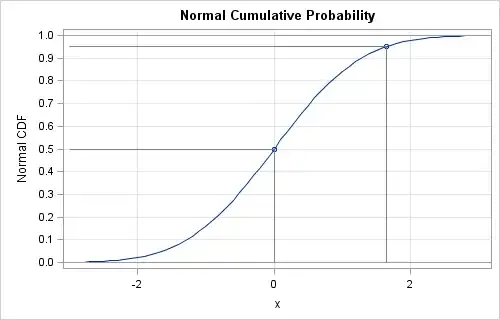

The Cumulative Distribution Function (CDF, sometimes just called the distribution function) of a continuous distribution (like the normal distribution) gives you the proportion of the distribution less than or equal to a given quantile (i.e., a given point in $X$).
The Probability Density Function (PDF) is the derivative of the CDF. That is, it gives the rate of change in the CDF (how fast it is increasing) associated with a given quantile.
It does not give the probability of drawing that quantile from the distribution. It can't, because there is no finite probability associated with a point from a continuous distribution. Remember that in math / geometry, a point has no finite width, and probability is defined as the area under the curve. Thus, we can take the height of the curve at a given quantile $f(x)$ and multiply it by the width, which is infinitely narrow (call it '$0$' if that's easier to think about), and the area will always be infinitely small. This is not intuitive for people, because we think of a point being something like $1.2$, not $1.2\bar{0}$ (where $\bar 0$ means infinitely repeating $0$s); in other words, people think of $1.2$ as the interval $[1.15, 1.25)$, where any value within that interval is $\approx 1.2$. There is a finite probability associated with that, because it does have a finite width (even if small). However, because that has a measurable width, it isn't a point.
