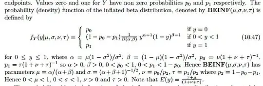

I am estimating a zero/one inflated beta regression model with gamlss (family BEINF). My dependent variable is [0,1] with a lot of 0s, quite some 1s, and some values in between. This means I assume that my model consists of three submodels:
Reference formula: Rigby & Stasinopoulos (2010), A Flexible regression approach using GAMLSS in R, section 10.8.2, p 215.
With regard to link functions used, this source gives a nice table (see BEINF)
In R, the coefficients of these submodels are addressed by Nu (zero-probability), Mu and Tau (one-probability)?
gam<-gamlss(y_proportion ~ x1+x2, nu.formula=~x1+x2, tau.formula=~x1+x2, family= BEINF,data=Alldata)

My question is related to Mu. What exactly is this?
  • Some people tell me this is the "mean". But do they mean the "mean" of the entire model (all three of them together) and is it therefore comparable with mean(y).
  • Or is it only the mean of the middle model (and is it therefore not taking into account 0 and 1)? I am assuming it is the last answer but I am confused. Thanks for your help!

  • Might be easier to answer if you gave clearer references. The first formula (from where?) uses a completely different set of parameters on the left side to on the right side! What does thegamlss documentation say? – Scortchi - Reinstate Monica Dec 29 '16 at 20:37
  • Oh snap! I thought I gave the references. I will add them, thanks! The gamlss is only explaining Tau and Nu (as far as I know because it is a big manual). – user33125 Dec 29 '16 at 20:39
  • I also added a table for the parameters on the left side. I have always understood these as an indication of the distribution used for the different submodels. – user33125 Dec 29 '16 at 20:48
    The definitions of the parameters $\mu$ &c. are given immediately below Equation 10.47. I'd suggest you include them in your question, as they;re essential to answering it. – Scortchi - Reinstate Monica Dec 29 '16 at 20:48
    The table's of the link functions used. – Scortchi - Reinstate Monica Dec 29 '16 at 20:51
    Thanks for the suggestions/clarifications. I edited the question. Hope it is clear now! – user33125 Dec 29 '16 at 20:56
    Thank you. It's clear, I believe. Briefly, $\mu$ is the mean of the beta distribution, the middle model. The mean of the entire model is given by $\operatorname{E}{y}=\frac{\tau + \mu}{1+\nu+\tau}$. An answer will go into more detail. – Scortchi - Reinstate Monica Dec 29 '16 at 21:16
