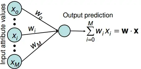

I want to know the difference between linear regression in a regular machine learning analysis and linear regression in "deep learning" setting. What algorithms are used for linear regression in deep learning setting.

Assuming that by deep learning you meant more precisely neural networks: a vanilla fully connected feedforward neural network with only linear activation functions will perform linear regression, regardless of how many layers it has. One difference is that with a neural network one typically uses gradient descent, whereas with "normal" linear regression one uses the normal equation if possible (when the number of features isn't too huge).
Example of a fully connected feedforward neural network with no hidden layer and using a linear activation function (namely the identity activation function):
If you replace the activation function of the output layer with a sigmoid function, then the neural network performs logistic regression. If you replace the activation function of the output layer with a softmax function and add a few output units, then the neural network performs multiclass logistic regression: Difference between logistic regression and neural networks. If you replace the cost function with the hinge loss, then the neural network is an SVM optimized in its primal form: http://cs231n.github.io/linear-classify/.
Here is the example shown in the picture above programmed in TensorFlow:

Franck Dernoncourt

  • Thanks so much for detailed answer and time you spent writing this. I need some time to digest this, and will get back to you with comments/questions! Thanks again! – tired and bored dev Dec 28 '16 at 03:04
  • Combining yours and Sengiley's answer with what I've understood, can I say - regression in deep learning has 1. 3+ number of hidden layers ; 2. Activation function is linear(or Identity Activation function); 3. Loss function we optimize is mean square error in the output layer. Thank you! – tired and bored dev Jan 28 '17 at 03:01
For regression, which for deep learning is nonlinear in most cases, final layer has 1 neuron with identity function and loss function we optimize is MSE, MAE instead of binary or categorical cross-entropy used for classification.

  • Hey thanks! I hope I'm not asking for too much, but could you please point me to paper/algorithm implementation? I tried to search, but mostly I found logistic regression related stuff :( – tired and bored dev Dec 27 '16 at 11:05
