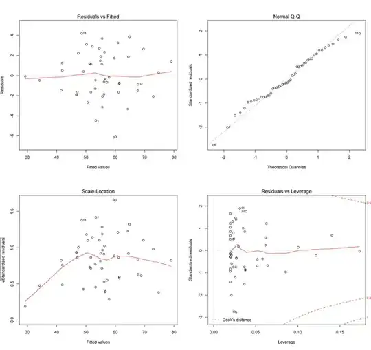

The first graph: residual vs fitted plot
A good residual vs fitted plot has three characteristics:
  • The residuals "bounce randomly" around the 0 line. This suggests that the assumption that the relationship is linear is reasonable.
  • The residuals roughly form a "horizontal band" around the 0 line. This suggests that the variances of the error terms are equal.
  • No one residual "stands out" from the basic random pattern of residuals. This suggests that there are no outliers.
(Source: https://onlinecourses.science.psu.edu/stat501/node/36 link not working January 2019)
In particular, I am no sure what they mean what they mean by a horizontal band in the second point.Is that the red curve in the graph?
So the second point deals with homoscedasticity?

To follow up on @mdewey's answer and disagree mildly with @jjet's: the scale-location plot in the lower left is best for evaluating homo/heteroscedasticity. Two reasons:
  • as raised by @mdewey: it's easier to judge whether the slope of a line than the amount of spread of a point cloud, and easier to fit a nonparametric smooth line to it for visualization purposes
  • a data set with a non-uniform distribution of the fitted value (which is not itself problematic) can fool the viewer into believing there's heteroscedasticity, because your eye tends out to pick out the extremes. Because more observations lead to more extreme residuals (in the sense of order statistics), it will appear that there's more variability in ranges with more data. In this case there are fewer points toward the extremes of the fitted values, which makes it look like the variability is highest in the middle. The scale-location plot avoids this problem.
Ben Bolker
  • 43,543
If you are looking at the top left plot then yes. However the best plot for what you intend is the bottom left one which folds the residuals about the horizontal axis in the first one so that the smoothed line drawn on that plot should be horizontal if there is no relation between scale and location. In your case it looks not too bad as the left hand dip is probably only being driven by a couple of points.
mdewey
  • 17,806
The second point is best evaluated using the top-left plot. Basically, you want to check to see whether the spread of the residuals is the same at all points along the x-axis. If it is, then you'll see a band of points that move horizontally along the x-axis. This would then suggest little evidence of heteroscedasticity. If instead it appears that the points either increase or decrease as you go from right to left, then you might say that "the band of points is increasing/decreasing" rather than staying strictly horizontal. The notion of a "band" of points is really just referring to the overall subjective shape of the scatterplot rather than anything specific.
