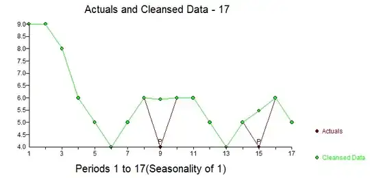

Your 17 data points suggests the need for a hybrid model incorporating not only memory (ARIMA) but an adjustment for 1 or more data points that do not follow the ARIMA regimen. Here is what might be a "useful model" enter image description here using AUTOBOX ( R version is available) , a piece of software which I have helped to develop that speaks to the challemges you raise. Since this data is relatively trivial in it's complexities there are some free remedies in R including auto.arima which might help you in this simple case. The problem with auto.arima is that it doesn't challenge the exceptional values but believes them and then gets confused as it attempts to form an ARIMA structure.
. The issue/objective is plain and clear ... determine the best composite between memory and deterministic structure. Here is another view of the model enter image description here .
THe Actual/Fit and Forecast graph is promising .enter image description here and the Actaul/Cleansed graph is informative enter image description here . The plot of the reenter image description heresiduals suggest sufficiency with 17 points . You can only do so much with 17 points and 13 degrees of freedom ! I suggest that you try different remedies ( R software solutions) on this data and then increasingly become more aggressive in simulating real-world data with level shifts , time trends , changing error variance , changing parameters , pulses , seasonal pulses et al and see how that works out for you. This can also be done while incorporating effects of X (eXogenous series).
The confidence limits on the forecast reflect re-sampling of the model errors possibly incorporating future anomalies .
Moenter image description heredel expressed as pure right-hand side equation
P.S. For pedagogical purposes, I specified a TREND MODEL (deterministic trend) and rejected any and all possible modifications and obtained the following simple/inadequate solution enter image description here . As another example of what not to do , I specified a sytochastic trend model ... first differences plus constant .. and obtained an equally poor soultion ..enter image description here
