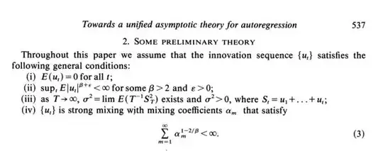

Here is a screenshot from Phillips (Biometrika 1987) stating assumptions on the errors - as you see, these are way broader than requiring normality.
That said, the asymptotic distribution does not have a closed-form solution, so that you need to simulate from the distribution to get critical values (existing infinite series representations are not practical either to generate critical vales). To perform that simulation, you must draw erros from some distribution, and the conventional choice is to simulate normal errors.
But, as Phillips shows, if you were to draw the errors from some other distribution satisfying the above requirements, you would asymptotically get the same distribution. You could replace the line with rnorm(T) with some such distribution in my answer here to verify.

  • I do not think there is a clash. My answer cites the asymptotic distribution, which does not assume normal errors, as Phillips' theorems unequivocally show. That said, the asymptotic distribution does not have a closed-form solution, so that you need to simulate from the distribution to get critical values (existing infinite series representations are not practical either to generate critical vales). To perform that simulation, you must draw erros from some distribution, and the conventional choice is to simulate normal errors. But, as Phillips shows, if you were to draw the errors from... – Christoph Hanck Aug 12 '20 at 14:30
  • ...some other distribution satisfying the above requirements, you would asymptotically get the same distribution. You could replace the line with rnorm(T) with some such distribution in my answer here https://stats.stackexchange.com/questions/213551/how-is-the-augmented-dickey-fuller-test-adf-table-of-critical-values-calculate/213589#213589 to verify. That said, the finite-sample distribution will of course be affected by the error distribution, so that the error distribution will play a role in shorter time series. – Christoph Hanck Aug 12 '20 at 14:32

Sufficient conditions, which are more general than those from Phillips and Perron (1987) quoted above, were known prior, if not in the time series literature. See, for example, McLiesh (1975):
  • The strong mixing condition (iv) of Phillips and Perron implies McLiesh's mixingale condition under some conditions.
  • Condition (ii) of Phillips and Perron requiring uniform bound on $2 + \epsilon$ moments of $\{ u_i\}$ is relaxed in McLeish to the uniform integrability of $\{ u_i^2 \}$.
  • Condition (iii) of Phillips and Perron is actually not quite correct/sufficient as intended.

  • @mlofton The statements in Phillips-Perron clearly says normality is not required at all, that's a basic fact (those results are plainly true, if not exactly under the conditions they claim). "...DF tables do assume normality..."---yes, in Dickey and Fuller (JASA 1979 and Econometrica 1981). That's why unit root tests were not widely considered by empirical folks prior to Phillips---it's not reasonable to have to always assume i.i.d. N(0,sigma^2) errors for a time series. The assumptions and derivations in those papers are very primitive by today's standards. – Michael Aug 23 '20 at 14:15
