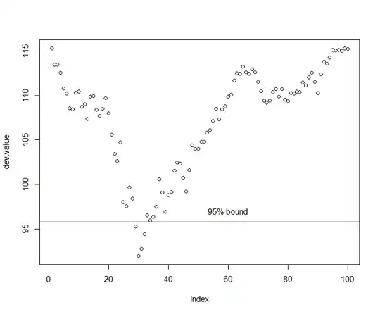

# Calculate profile-ll based confidence interval
estimate <- which.min(dev.value)
profile.95.dev <- min(dev.value) + qchisq(0.95,1)
est.lb.95 <- max(which(dev.value[1:estimate] > profile.95.dev))
est.ub.95 <- est -1 + min(which(dev.value[estimate:length(y)] > profile.95.dev))
> estimate
[1] 30
> est.lb.95
[1] 28
> est.ub.95
[1] 33
So our estimate is 30 with a 95% confidence interval of 28 - 33. Pretty tight, but that was a pretty big shift relative to the standard deviation of the error term too.
Note some messiness is involved in calculating the profile log-likelihood based confidence interval, but the basic idea is to find the largest index less than the estimate with a deviance greater than the cutoff level for the lower bound and the smallest index larger than the estimate with a deviance greater than the cutoff level for the upper bound.
One really should plot the deviance curve out, just to make sure you don't have multiple local minima that are close to as good as each other, which might tell you something interesting about the assumed model (or the data):
