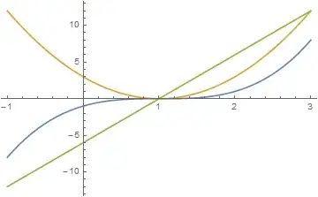

Finally, note that we did not classify $f'(0)=0$ and $f''(x)=0$, which may be indeterminate (e.g., for a flat line it is both a global minimum and maximum) but which can be neither a minimum or a maximum, e.g., at a zero-slope, inflection and saddle point. For example, let $f(x)=x^3-3 x^2+3 x-1$, then $f(1)=0,f'(1)=0,f''(1)=0$ and the plot of $f(x)$ and its first two derivatives in blue orange and green, respectively, is
