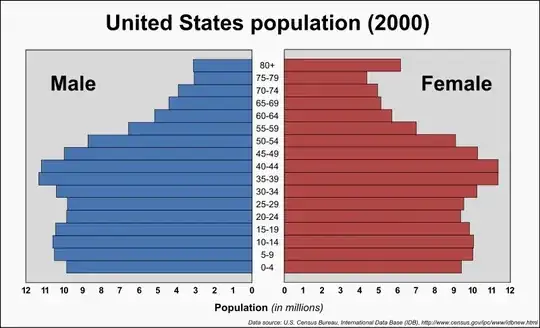

Age pyramid looks like this: alt text
I would like to make something similar, namely a 2 barplots (not histograms) with same categories, rotated vertically and extending to both sides as in pyramid.
Is it a simple way to do this in R?
It would be also nice to control the colour of each bar.

You can do this with the pyramid.plot() function from the plotrix package. Here's an example:
library(plotrix)
 xy.pop<-c(3.2,3.5,3.6,3.6,3.5,3.5,3.9,3.7,3.9,3.5,3.2,2.8,2.2,1.8,
  1.5,1.3,0.7,0.4)
 xx.pop<-c(3.2,3.4,3.5,3.5,3.5,3.7,4,3.8,3.9,3.6,3.2,2.5,2,1.7,1.5,
  1.3,1,0.8)
 agelabels<-c("0-4","5-9","10-14","15-19","20-24","25-29","30-34",
  "35-39","40-44","45-49","50-54","55-59","60-64","65-69","70-74",
  "75-79","80-44","85+")
 mcol<-color.gradient(c(0,0,0.5,1),c(0,0,0.5,1),c(1,1,0.5,1),18)
 fcol<-color.gradient(c(1,1,0.5,1),c(0.5,0.5,0.5,1),c(0.5,0.5,0.5,1),18)
 par(mar=pyramid.plot(xy.pop,xx.pop,labels=agelabels,
  main="Australian population pyramid 2002",lxcol=mcol,rxcol=fcol,
  gap=0.5,show.values=TRUE))
Which ends up looking like this: alt text
