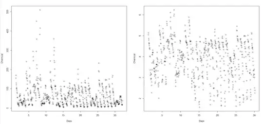

I have been given a dataset containing around 700 observations of the amount of a certain chemical in the air. The observations are measured once every hour, so for each day, i have 24 observations.
I am now tasked with identifying a ARIMA model for the data. A plot of the data aswell as the log transformed data can be seen here: enter image description here
It is easy to see that this must be a 24 hour seasonal model, which is also given as a hint in the assignment. It was also given as a hint that i should log transform the data, which i have done.

This question is similar to yours (they had 90 days ...you have 30 days ) Robust time-series regression for outlier detection . The whole idea is to build a model for the daily totals and then use daily total as a predictor variable for each of the 24 hourly models.
edit after a (visual) review of your data ..it is clear that have fixed daily effects and fixed hourly effects and outliers and a level shift (down) ... that having been said there may also be some arima structure ..
power transformations ( like logs ) are not visually obvious .
Only your data knows what else is needed .
