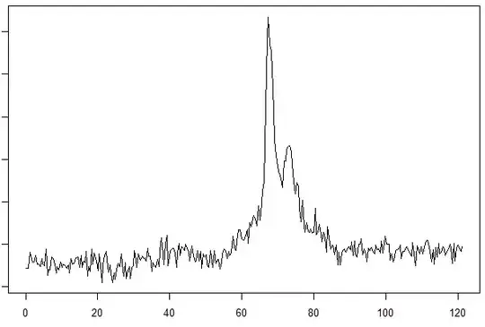

Below I have included some plots of the data. To be upfront, the x axis is time, but is better understood as a measure of a chemical property that can be expressed continuously. Components have discrete values in x, but elute as distributions due to to various non-ideal effects in the experiment. I am trying to recover the individual components, but more realistically to separate the well resolved components and the noise depicted as a fluctuating baseline in figure 3.

Example density Example density 2 Noisy density 3
