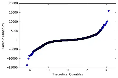

However, I'm having problems when I check assumptions. My residuals to not appear to be normally distributed.

If I plot a qq of the residuals I get this:
Which I understand to be a fat-tailed distribution.

I have run into this kind of situation many a time myself. Here are a few comments from my experience. Rarely is it the case that you see a QQ plot that lines up along a straight line.
  1. The linearity suggests the model is strong but the residual plots suggest the model is unstable. How do I reconcile? Is this a good model or an unstable one?
Response: The curvy QQ plot does not invalidate your model. But, there seems to be way too many variables (20) in your model. Are the variables chosen after variable selection such as AIC, BIC, lasso, etc? Have you tried cross-validation to guard against overfitting? Even after all this, your QQ plot may look curvy. You can explore by including interaction terms and polynomial terms in your regression, but a QQ plot that does not line up nicely in a straight line is a not a substantial issue in practical terms.
Say you are comfortable with retaining all 20 predictors. You can, at a minimum, report White or Newey-West standard errors to adjust for collinearity among the 20 predictors as well as autocorrelation and heteroskedasticity. Your residual plots indicate few clear outliers. You can drop these observations and your QQ plot will look less curvy.
  1. If the model is unstable, how can I transform the variables (independent, dependent, both) to get my residuals normally distributed while maintaining strong linearity. I've tried various transformations (log, ln, box cox, etc) on the dependent variable, all independent variables, and some independent variables and all it does is destroy the linearity while not fixing the residual distribution.
Response: The transformations you tried are all good to try. You need not be fixated on fixing the residuals plot. Even if the QQ plot does not line up on a straight line, your estimated OLS coefficients are still unbiased and consistent. What is impacted is your standard errors of those OLS coefficients, and you can apply common fixes such as White, Newey-West, or boostrapping to get a conservative estimate of the standard errors so that you do not conclude a coefficient is significant when it is not.

  • Thanks very much for the comments and perspective. I was taught that satisfying the assumptions are "very important - otherwise your model is unstable" which is why I'm so fixated. I should add that I'm really only at the outset here. I agree that 20 predictors is too many. Have not gone through any kind of feature selection yet. Just approaching this one step at a time and since I got such good fit (.95 R^2) I just wanted to resolve what I thought to be the key issue with the normality of residuals before I moved on to refine the model. – Windstorm1981 Oct 26 '16 at 14:38
  • ...I thought what I had here (non-normal distribution or residuals) invalidated the model at the outset but was confused since I had such great fit before I did any more work - but if I understand you correctly @David the model is ok despite the funky qq? – Windstorm1981 Oct 26 '16 at 14:39
  • could you explain this part a little more simply? TY "What is impacted is your standard errors of those OLS coefficients, and you can apply common fixes such as White, Newey-West, or boostrapping to get a conservative estimate of the standard errors so that you do not conclude a coefficient is significant when it is not." – Windstorm1981 Oct 26 '16 at 14:45
  • If you can justify retaining a large number of predictors, and mitigate the risk of overfitting by, say, cross valiation, your model seems OK. If the QQ plot lines up nicely, then great, and even if not, it's not a deal breaker. – DavidH Oct 26 '16 at 16:21
  • is using cross validation for linear regression the same as for non-parametric models? e.g., hold out a test set, fit the model using the training set making x number of folds, then ultimately testing against the test set? Thx. If I recall one generally doesn't have to do this because the differences in models are so small? Thx in advance. – Windstorm1981 Oct 26 '16 at 16:28
    Normality assumption is not needed for OLS coefficients to be BLUE (BestLinearUnbiasedEstimator). The formula for deriving coefficients doesn't use nor need normality. However, when you want to make inferences about your OLS coefficients, then normality assumption becomes material. Rarely will all the OLS assumptions be met in practice. Faced with curvy QQ plot (i,e. some evidence of non-normal error terms), you can use bootstrap to construct an empirical confidence intervals (CI's) of your OLS estimates based on the realized residuals from your model, and use those CI's to perform inference. – DavidH Oct 26 '16 at 16:30
  • You can also look at standard errors adjusted for autocorrelation+heteroskedasticityr via Newey-West standard errors (if your data is time series), or just for heteroskedasticity via White standard errors (if your data is cross-sectional). – DavidH Oct 26 '16 at 16:33
  • Cross validation (CV) for linear regression is different from nonparametric models. You can perform CV on either parametric (linear regression) or nonparametric models, as long as the spirit of CV is to randomly split the data as development or test sets. If your data is time series, randomly splitting the entire data would not work, and instead, would need to do some out-of-sample forecasting and check against realized. – DavidH Oct 26 '16 at 16:36
