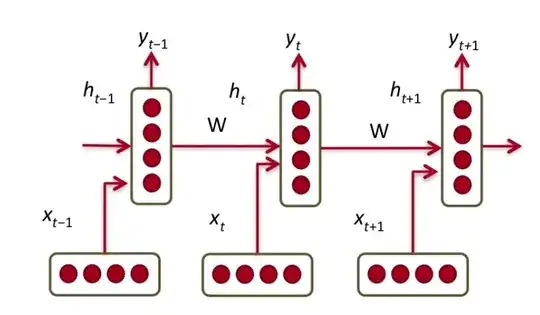

14
Most LSTM/RNN diagrams just show the hidden cells but never the units of those cells. Hence, the confusion. Each hidden layer has hidden cells, as many as the number of time steps. And further, each hidden cell is made up of multiple hidden units, like in the diagram below. Therefore, the dimensionality of a hidden layer matrix in RNN is (number of time steps, number of hidden units).
    Seems confusing. So, what's in the diagram? A hidden cell that has multiple hidden units? But you just said hidden cells are correlated with time steps. Ah, I am confused as well. – Ray Jasson Jan 27 '22 at 17:40
  • The LSTM layer in the diagram has 1 cell and 4 hidden units. The diagram also shows that Xt is size 4. It is coincidental that # hidden units = size of Xt. Xt can be any size. Importantly, there are NOT 3 LSTM cells. The diagram is just trying to illustrate the sequential dependency of the inputs and outputs of the one LSTM cell. – user3062149 May 25 '22 at 04:07
  • So the 4 "cells" in each of the x values, are they different parameters, eg. temperature, humidity? If this was a language model where each x value was a word, would we only have 1 circle at each x time step? – gazm2k5 Aug 05 '22 at 19:05
