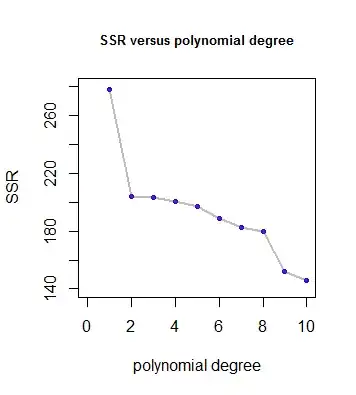

Here is an example with the dataset mtcars plotting the predicted polynomial lines on the data points of miles per gallon (mpg) versus weight (wt) of different car models, resulting from increasing polynomial order models from $1$ to $10$:
Although the relationship is fairly linear, as can be inferred from general knowledge about cars, and from inspecting the data points, as the the degree of the polynomial model increases the predicted points fall closer and closer to the actual data points because there is increased ability to accommodate individual variations resulting from noise in the data.
Concomitantly, there is a drop in the RSS:
all of it at the expense of overfitting and increased out-of-sample error.
