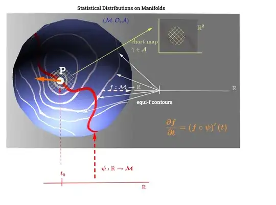

I have drawn this diagram inspired by this explanation of the tangent space here:
[Edit to reflect the comment below about $C^\infty$:] On a manifold, $(\mathcal M)$, the tangent space is the set of all possible derivatives ("velocities") at a point $p\in \mathcal M$ associated with every possible curve $(\psi: \mathbb R \to \mathcal M)$ on the manifold running through $p.$ This can be seen as a set of maps from every curve crossing through $p,$ i.e. $C^\infty (t)\to \mathbb R,$ defined as the composition $\left(f \circ \psi \right )'(t)$, with $\psi$ denoting a curve (function from the real line to the surface of the manifold $\mathcal M$) running through the point $p,$ and depicted in red on the diagram above; and $f,$ representing a test function. The "iso-$f$" white contour lines map to the same point on the real line, and surround the point $p$.

Would this indicate that data lie on the surface of the manifold expressed as tangent vectors, and parameters would be mapped on a Cartesian plane?

    The short answer to your edited question is "no." The tangent space describes the velocities of all smooth paths in the manifold. Its principal role in statistics is in maximizing likelihoods, where the manifold describes a finitely parameterized family. In "manifold learning," a manifold is used as a local approximation to data--it's a curved version of the "column space" in linear regression. There, the tangent space is embedded within the ambient Euclidean space. Locally, it describes the "directions" of the data and its normal bundle gives the "error" directions. – whuber Sep 13 '17 at 13:26
  • (BTW, your initial characterization of the tangent space as a family of maps $f:\mathbb{R}\to\mathbb{R}$ seems corrupted; it's certainly not correct.) – whuber Sep 13 '17 at 13:50
  • @whuber Is the current version closer to the truth in re: to your last correction? – Antoni Parellada Sep 13 '17 at 14:19
  • Sort of. "$C^\infty$" is not used correctly, though. The underlying idea is that functions $f:M\to\mathbb{R}$ can have various directional derivatives at any given point $p\in M$. The values of those derivatives at $p$ form a vector space whose dimension is identical to that of $M$. This is the tangent space $T_pM$. It is not a set of "possible maps," though. (A more modern definition of $T_pM$, inspired by abstract algebraic geometry, is a set of maps: it is the dual vector space--the space of linear forms--of the space of derivations of germs of functions defined around $p$.) – whuber Sep 13 '17 at 15:11
  • @whuber Are you referring to the cotangent space, akin to $V^*$? – Antoni Parellada Sep 13 '17 at 15:15
    Yes: the cotangent space $T_p^{}M$ at $p$ can be defined as the derivations of germs of functions around $p$. The tangent space at $p$ (therefore!) is simply its dual. $T^{}M$ and $TM$ acquire a topology--that is, admit a notion of two tangent spaces $T_pM$ and $T_qM$ being "near"--by means of the coordinate charts on $M$. This reduces the definition (and the problem of visualization) to that of defining the tangent space $T_x\mathbb{R}^n$. This is the set of all vectors originating at $x$. Spivak, in Calculus on Manifolds, provides a clear, elementary definition of this sort. – whuber Sep 13 '17 at 15:20
