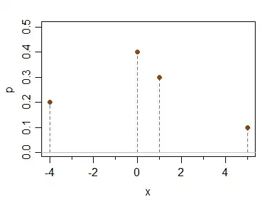

Consider the following discrete distribution:
  x     -4    0    1    5
P(X=x)  0.2  0.4  0.3  0.1
It has mean, median, mode and third central moment (and hence moment-skewness) all 0 but it is asymmetric.
Asymmetric discrete pmf with mean=median=mode and moments skewness 0

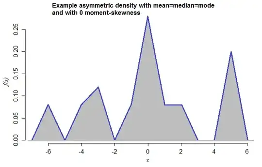

This sort of example can be done with a purely continuous distribution as well. For example, here's a density with the same properties:
Asymmetric density with mean, median and mode 0 and zero moment-skewness
This is a mixture of symmetric triangular densities (each with range 2) with means at -6, -4, -3, -1, 0, 1, 2, 5 and mixture weights 0.08, 0.08, 0.12, 0.08, 0.28, 0.08, 0.08, 0.20 respectively. The fact that I just made this now -- having never seen it before -- suggests how simple these cases are to construct.
[I chose triangular mixture components in order that the mode would be visually unambiguous -- a smoother distribution could have been used.]

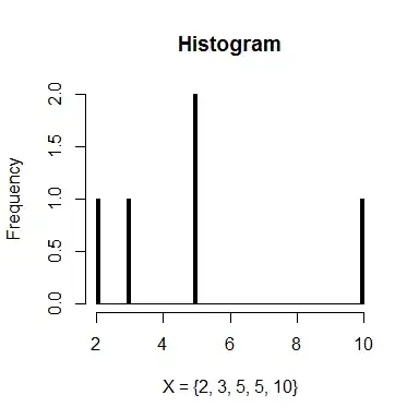

Try this set of numbers:
\begin{align} X &= \{2,3,5,5,10\} \\[10pt] {\rm mean}(X) &= 5 \\ {\rm median}(X) &= 5 \\ {\rm mode}(X) &= 5 \end{align}
Histogram
I wouldn't call that distribution symmetrical.

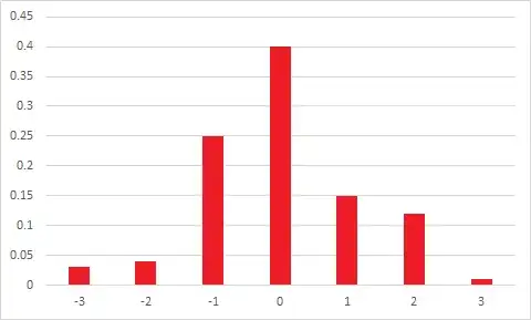

To repeat an answer I gave elsewhere, but fits here too:
$$\mathbb{P}(X=n) = \left\{ \begin{array}{ll} 0.03 & n=-3 \\ 0.04 & n=-2 \\ 0.25 & n=-1 \\ 0.40 & n=0 \\ 0.15 & n=1 \\ 0.12 & n=2 \\ 0.01 & n=3 \end{array} \right.$$
which not only has mean, median and mode all equal, but also has zero skewness. Many other versions are possible.
