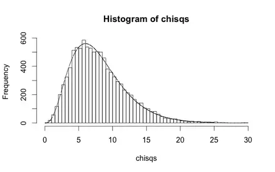

The case of the Hosmer-Lemeshow test for logistic regression is very similar. Here are two small simulations analogous to the above linear regression simulation. In the first, there is an independent variables $x$ and a dependent binary variable $y$. Previous research has shown that the probability that $y$ is true is $\pi = 1/(1+\exp(-[0.1+0.5x]))$. Assuming this is exactly true (the null hypothesis), the following code simulates 10 thousand cross-checks where this prediction is applied to new data and checked against the known values $y$, at each step calculating the Hosmer-Lemeshow statistic. The result follows a chi-square distribution with 10 degrees of freedom -- one for each partition used in the test:
library(ResourceSelection)
n <- 500; chisqs <- c()
for (i in 1:10000) {
    x <- rnorm(n)
    p <- plogis(0.1+0.5*x)
    y <- rbinom(n,1,p)
    x2 <- hoslem.test(y,p)$statistic
    chisqs <- cbind(chisqs,x2);
h <- hist(chisqs,50)
xs <- seq(0,25,0.01)
ys <- dchisq(xs,df=10)
lines(xs,ys*h$counts/h$density)

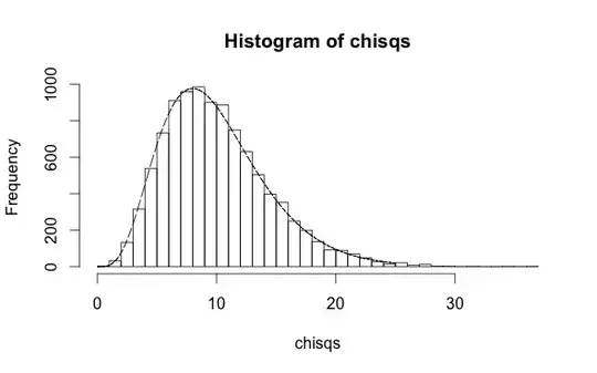

On the other hand, if you use the values of $y$ to make a fit and create the predictions, you'll clearly do better because you've peeked at the answers during the minimization. In this case the degrees of freedom in the distribution of the HL statistic are 8:
    x <- rnorm(n)
    y <- rbinom(n,1,p)
    fit <- glm(y~x,family="binomial")
    x2 <- hoslem.test(y,fitted(fit))$statistic
ys <- dchisq(xs,df=8)
This is exactly equivalent to the difference in degrees of freedom for the MSE distributions. Since linear regression is more popular, you're more likely to find sources in the literature verifying what I've claimed and shown here in the linear regression use-case.

The code contains comments to point to the major steps in the simulation. It is mainly a loop that is executed $N$ times, in each loop one has:
  1. Draw a training sample
  2. Estimate the logistic model
  3. Predict the probabilities using the estimated coefficients
  4. Compute the HL X2
The helper functions are defined at the end of my answer.
simulateHosmerLemeshowX2<-function(N=5000, sampleSize, b0=-4) {
  x2HL<-vector(mode="numeric", length=N)
  for (i in 1:N) {
    # draw a training sample
    trainSample<-generateSample(sampleSize, b0)
    # train a logistic model
    logisticModel <- glm(y~x1+x2,family="binomial",data=trainSample$sample)
    #predict the probabilities using the estimates
    predictedPs<-predict(logisticModel, newdata = trainSample$sample, type = "response")
    # compute the Hosmer-Lemeshow statistic
    x2HL[i] <- hoslem.test(trainSample$sample$y,predictedPs)$statistic
  p<-plotSimulatedX2(x2HL, N=N,title = "H0: model predicts probabilities well (Hosmer-Lemeshow)", df.chi=8)
  return(list(graph=p, N=N))
simulateHosmerLemeshowX2(sampleSize=500, b0=-4)
One can execute this simulation, you will find a graph like the one below:
The bars represent the simulated test statistic of Hosmer-Lemeshow, the smooth curve is a simulated $\chi^2(8)$. It seems to conform the findings of HL. Note that the mean of the test statistic is close to 8 and that the mean of a chi-square is the number of degrees of freedom. enter image description here
Simulations for ''out-of-sample'' validation
In this section I simulate the out-of-sample situation. The code and one result are below.
  1. Draw a sample
  2. Split it into a training and a validation sample
  3. Estimate the logistic model on the training sample
  4. Predict the probabilities using the estimated coefficients on the validation sample
  5. Compute the HL X2 on the validation sample
The graphs shows that the test statistic, compute on the validation sample, is not $\chi^2(8)$, the mean seems to indicate that one might conclde that it is $\chi^2$ with 13 df, but, as indicated in the graph, then the variance is not compatible with a chi-square ?
simulateHosmerLemeshowOutOfSampleX2B<-function(N=5000, sampleSize, b0) {
  for (i in 1:N) {
    # generate a sample
    fullSample<-generateSample(2*sampleSize, b0)
    # split the sample in two equal parts; one for training and one for validation
    idx<-sample(x = 1:(2*sampleSize), size = sampleSize)
    trainSample<-fullSample
    trainSample$sample <-fullSample$sample[idx,]
    trainSample$truePs <-fullSample$truePs[idx]
    validationSample<-fullSample
    validationSample$sample <-fullSample$sample[-idx,]
    validationSample$truePs <-fullSample$truePs[-idx]
    # train a logistic model on the training sample
    # use the trained model on the validation sample
    predictedPs<-predict(logisticModel, newdata = validationSample$sample, type = "response")
    # compute HL on the validation sample
    x2HL[i] <- hoslem.test(validationSample$sample$y,predictedPs)$statistic
  p<-plotSimulatedX2(x2HL, N=N,title = "H0: model predicts probabilities well, Out of Sample \n Splitted sample",
                     df.chi=12)
simulateHosmerLemeshowOutOfSampleX2B(sampleSize=500, b0=-4, N=5000)

In the original paper, Hosmer and Lemeshow used 8 df (with 10 decile groups) for estimating the model on development data. For validation data, you would use 9 df (df= # of groups - 1), based on what I've seen in literature.
Edit: I haven't got a reference to support the choice of 9 df.
