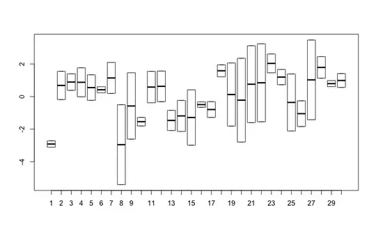

I measured explorative behaviour of 29 individuals repeatedly (at least twice) since I’m interested in how consistent they are through time. It seems, based on the attached plot, that there are clear differences between individuals in exploration. However, when I use a Linear mixed effect model with ID as a random variable

enter image description hereThe random effect (between individual variance in exploration) is zero. This seems very weird and I can’t explain this. I have no idea what the problem is.
You say that each individual had at least two measurements, but from your output there are only 66 observations on 30 individuals, so only six individuals (at most) had more than two measurements. Two is the absolute minimum you need to calculate a mean and a standard distribution -- the random intercept is assumed to be a Normal distribution -- which will have a LOT of uncertainty. Looking at the plot, you have at least five individuals with essentially zero variance, and at least five individuals with a HUGE variance (probably caused by only two observations each).
I'd say you have too little data that's too noisy. The "clear" differences you see are mostly illusory because of the lack of data resulting in huge swings.

Here is a box plot of 30 individuals, where I chose two random normal numbers (mean 0, sd 2) for each:
Plot of 30 individuals, two random normal each
Compare to where I picked twenty numbers for each (same mean and sd):
Plot of 30 individuals, twenty random normal each
The first plot looks a lot like your plot. If I chose more than twenty each, it would even out even further.
