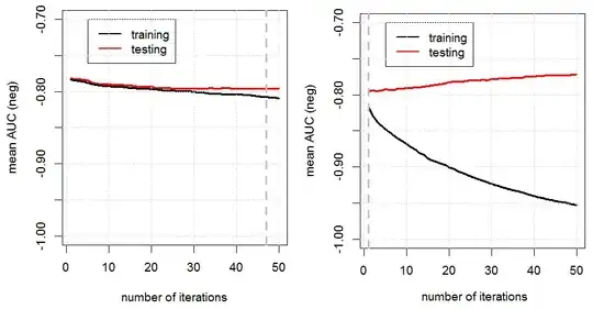

One way to check if the model is "under-fitting" or "over-fitting" is plot "learning curve".
Such method is not limited to logistic regression. But in logistic regression, you may want to care more about under-fitting but not over-fitting.
Details can be found in my answer here
How to know if a learning curve from SVM model suffers from bias or variance?
  • If two curves are "close to each other" and both of them but have a low score. The model suffer from an under fitting problem (High Bias)
  • If training curve has a much better score but testing curve has a lower score, i.e., there are large gaps between two curves. Then the model suffer from an over fitting problem (High Variance)
Here are two examples of under fitting and over fitting.
Back to your question, if you plot learning curve and found the model has high bias, i.e, two curves are close and both has "low performance", then it is "lack of fit".

    I believe different concepts of "lack of fit" might be in play in this thread. The traditional meaning in a regression context is unrelated to predictability. Indeed, overfitting really means "fit that's too good to be true." One way to appreciate the distinction is that data generated exactly by a model $\Pr(Y=1)=\alpha+\beta X$ will be almost perfectly fit by logistic regression--there will be no lack of fit in the traditional regression sense--but if the range of the $\alpha+\beta X_i$ in the data is small, then the predictive quality of the model will appear to be poor. – whuber Sep 07 '16 at 16:39
    @whuber thank you for educating me that "lack of fit" has different meanings in different community ! – Haitao Du Sep 07 '16 at 19:57
