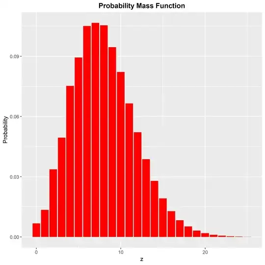

Taking the characteristic functions of the underlying random variables you have:
$$\begin{equation} \begin{aligned} \varphi_X(t) &= \exp \Big( 2 (e^{it}-1) \Big), \\[6pt] \varphi_{2Y}(t) &= \exp \Big( 3 (e^{2it}-1) \Big). \\[6pt] \end{aligned} \end{equation}$$
Assuming that $X$ and $Y$ are independent, you then have:
$$\varphi_Z(t) = \varphi_{X}(t) \cdot \varphi_{2Y}(t) = \exp \Big( 3 e^{2it} +2 e^{it} -5 \Big).$$
The distribution of $Z$ can be obtained by inverting the characteristic function via standard methods for inverse-Fourier transformation. Using a well-known inversion formula we have:
$$\begin{equation} \begin{aligned} p_Z(z) &= \lim_{T \rightarrow \infty} \frac{1}{2T} \int \limits_{-T}^{+T} e^{-itz} \varphi_Z(t) dt \\[6pt] &= \lim_{T \rightarrow \infty} \frac{1}{2T} \int \limits_{-T}^{+T} \exp \Big( 3 e^{2it} +2 e^{it} - itz -5 \Big) dt \\[6pt] \end{aligned} \end{equation}$$
This integral is hard to solve, so it is easier to proceed in this case by taking a standard convolution. Doing this yields the closed form solution:
$$\begin{equation} \begin{aligned} p_Z(z) &= \sum_{y=0}^{\lfloor z/2 \rfloor} p_Y(y) \cdot p_X(z-2y) \\[6pt] &= \exp(-5) \sum_{y=0}^{\lfloor z/2 \rfloor} \frac{3^y 2^{z-2y}}{y! (z-2y)!} \\[6pt] &= 2^z \exp(-5) \sum_{y=0}^{\lfloor z/2 \rfloor} \frac{(\tfrac{3}{4})^y}{y! (z-2y)!}. \\[6pt] \end{aligned} \end{equation}$$
You can create a function for this PMF in R as follows:
#Create probability mass function for Z
PMF <- function(z) { YY <- floor(z/2);
                     Y <- 0:YY;
                     for (i in 0:YY) { Y[i+1] <- dpois(i, 3)*dpois(z-2*i, 2); }
                     sum(Y); }
#Create data frame of PMF values from Z = 0,...,25
ZZ   <- 25;
Z    <- 0:ZZ;
Prob <- rep(0,length(ZZ));
for (z in 0:ZZ) { Prob[z+1] <- PMF(z) }
DATA <- data.frame(z = Z, Prob =  Prob)
#Plot the PMF
library(ggplot2);
FIGURE <- ggplot(data = DATA, aes(x = z, y = Prob)) +
          geom_bar(stat = 'identity', fill = 'red') +
          theme(plot.title = element_text(hjust = 0.5, face = 'bold')) +
          ggtitle('Probability Mass Function') +
          xlab('z') + ylab('Probability');
FIGURE;
