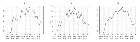

An alternative to Rob Hyndman's approach, to make a single data series, is to merge the data. This might be appropriate if your multiple time series represent noisy readings from a set of machines recording the same event. (If each time series is on a different scale you need to normalize the data first.)
NOTE: you still only end up with 28 readings, just less noise, so this may not be appropriate for your situation.
t1=xts(jitter(sin(1:28/10),amount=0.2),as.Date("2012-01-01")+1:28)
t2=xts(jitter(sin(1:28/10),amount=0.2),as.Date("2012-01-01")+1:28)
t3=(t1+t2)/2
Darren Cook
  • 2,107
  • 26
  • This will only work if all the signals are similar in nature (e.g. periodic) are all in phase - in your example if two of the sine waves were 180 degrees out of phase they would completely cancel! – tdc Feb 24 '12 at 09:43
    Yes, averaging your data is only appropriate when each date series is supposed to represent the same data, and (you are happy to assume that) they only differ in that each has different noise. – Darren Cook Feb 26 '12 at 01:34
