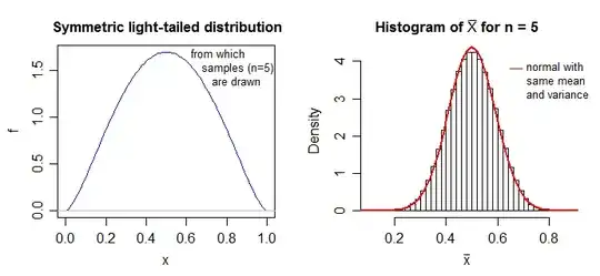

Here's an example for which samples of size 5 are pretty good (I can't tell whether they'll be close enough for your purpose though):
beta 2.5,2.5 density and distribution of sample means, which looks very close to normal at n=5
