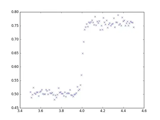

I am using a non linear least squares method to fit an analytical function to some experimental data. I have to provide some initial guess values to the algorithm, so I am trying to figure out how to do this automatically (rather than by eye, which is what I have been doing).
This is some simulated data, created by adding normally distributed random noise to the analytical function
I am trying reliably detect the position of this step change in the data. I have had some limited success by calculating the mean variance in the data points and looking for points in the data that differ significantly from this value, but this approach seems very limited by the signal to noise ratio.
I am hoping for some direction on what I need to look into to solve my problem, as I don't know much statistics at all.

There may be some more sophisticated methods for this but here is my first thought.
You basically want to take the derivative of the function and find where it is the largest. Numerically, you can just take the difference between data points and find which two points have the biggest difference. Then the midpoint of the x-values for these two points is your location of biggest change.
This simple method is susceptible to the noise. So you can first filter the data using a filter that does not shift the data to the right or left. If you use a simple FIR filter, then filter front to back and then filter the result from back to front. The result is a doubly filtered and NON shifted data set. Then follow the procedure above to find the point with the largest difference between values.
You can also use more sophisticated numerical differential calculations that use more then the difference of two points.

  • Thank you for the answer. I was hung up on the fact that this was discrete data, and didn't think to just differentiate it! I'm going to look into using the FIR filter on some of my smaller peaks, to see if this works – jm22b Aug 15 '16 at 14:13
    I have implemented your idea and it works like a charm, thanks a lot! – jm22b Aug 16 '16 at 09:40

One technique is to test all values of the x variable for the standard deviation of the data before and after it. For a true step function, the sum of those two will be minimal at the step location, and the minimum should be a good starting parameter for your nonlinear function.
Here is a plot of your original data (black), the standard deviation before x (blue), after x (red) and the sum of the last two (green).

I recognize that this question is old. But I wanted to throw another method out there. Canny wrote a paper (A Computational Approach to Edge Detection) where he solved this problem in the two dimensional case for edge detection in images. You can read the paper if you like, but to cut to the chase, you can get a very good approximation to the change point by doing the following:
  1. Perform the convolution of your signal with the derivative of the Gaussian.
$$ f(x) = \frac{-x}{\chi^2} e^{-\frac{x^2}{\sigma^2}} $$
where $\chi$ is a scaling factor.
  1. The peak of the response is where the change point occurs.
In my experience with this method, I have found that choosing the correct scaling parameters is difficult. But there may be more work on this that I am not aware of.
