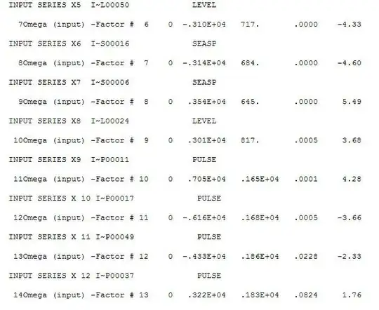

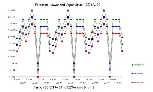

The problem/opportunity is to identify the underlying ARIMA or Seasonal Dummy Model and augment as needed . This particular series evidences string / dominant determinstic seasona dummies as compared to a seasonal ARIMA structure. We then identify both unusual values be they pulses, seasonal pulses, level shifts and or local time trends AND and autoregressive structure needed to generate "noise". Two Level Shifts were identified on or around time period 50 (2009/February) and period 24 (2006/December). The data suggested the following model enter image description here . The unusual values i.e. the PULSES enter image description here are listed here. A very illuminating graphic is the cleansed vs the actual shown hereenter image description here . Finally the fit/actual/forecast graph is a good ( but busy ) summaryenter image description here . The forecast graph is enter image description here . The final model statistics are shown in the last three images and enter image description here and enter image description here and enter image description here . The residuals from the model are reasonably random enter image description here with no remaining autoenter image description herecorrelative structure . Hope this little example helps all ! I am one of the developers of the software I used here . There are other commercially available products that will deliver something similar.
IrishStat
  • 29,661
  • Thank you for your answer IrishStat, I find it very very interesting! What's even more interesting to me is the fact that you did not need me to provide the number of working days in each month. So I guess the answer to my original question is: no, you don't need to pre-process data. A complex enough model can handle that already. Is this correct? As for outliers spotting, do I then apply Rob's method to the residuals you obtained, or are the "outliers" already taken care of when you cleansed the data from "pulses"? – Bruder Feb 17 '12 at 08:12
  • There are only 4 outliers/inliers/pulses in this model (periods 11,17,37 and 49). The only treatment I know is to examine these periods for possible "assignable cause" in order to possible evolve/deduce an unspecified predictor/exogenous series that was not incorporated/omitted from the model. In summary the outliers have been cleansed thus providing robust estimates of the other parameters. – IrishStat Feb 17 '12 at 10:38
    Again, thank you for your reply. Could you please provide more details about the cleansing process? How were the cleansed values actually computed? (BTW I'm now reading your AutoBox User's Giude, maybe I'll find some info in there?). Also what happened to level shifts? Shouldn't these be somehow incorporated in the model? Or am I missing something? I apologize for my lack of knowledge on this topic... – Bruder Feb 17 '12 at 11:29
  • :Bruder A good reference for this is http://www.unc.edu/~jbhill/tsay.pdf . Level Shifts were incorporated into the model (level shift at 24 and at 50 ) . At 24 the series went up and at 50 it went down . – IrishStat Feb 17 '12 at 11:59
  • :Bruder Note that six months of the year are earmarked for specific effects month 8/1/12/2/4 and 6. The starting date for these fixed effects are respectively 2005/8 ; 2005/1 ; 2006/12 ; 2005/2 ; 2006/4 and 2005/6 . What this means is that rather than assuming that the fixed effects (i.e. monthly effects ) are uniform over time , it is possible to detect the "onset" of these effects. It is quite naive to assume that the impact of a particular month is uniform through the 7 years. In terms of the ARIMA component , a lag of one was found which suggests an effect from the prior period's sales. – IrishStat Feb 17 '12 at 12:23
