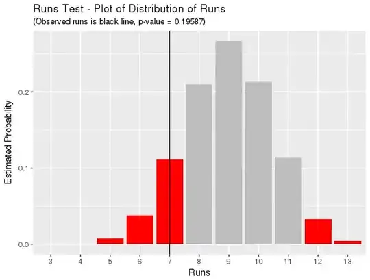

Implementation in R: Consider an example where we observe the sample vector:
$$\boldsymbol{x} = (5, 1, 2, 1, 5, 6, 8, 2, 4, 8, 9, 10, 4, 2).$$
We want to test to see if this came from an exchangeable distribution. This particular outcomes has $R(\boldsymbol{x}) = 7$ runs up and down. We can use R to simulate from the distribution of this statistic under exchangeability and perform a runs tests as follows:

#Plot estimated distribution of runs with test
library(ggplot2);
ggplot(data = FREQS, aes(x = RR, y = Freq/k, fill = (Freq <= R_FREQ))) +
geom_bar(stat = 'identity') +
geom_vline(xintercept = match(R, FREQS$RR)) +
scale_fill_manual(values = c('Grey', 'Red')) +
theme(legend.position = 'none') +
labs(title ='Runs Test - Plot of Distribution of Runs',
     subtitle = paste0('(Observed runs is black line, p-value = ', p, ')'),
     x = 'Runs', y = 'Estimated Probability');
This generates the following plot showing the estimate null distribution (under the assumption that the underlying distribution is exchangeable) and the p-value for the test:
In this case we see that the p-value is not very low, and hence there is insufficient evidence to reject the null hypothesis that this vector came from an exchangeable distribution.
