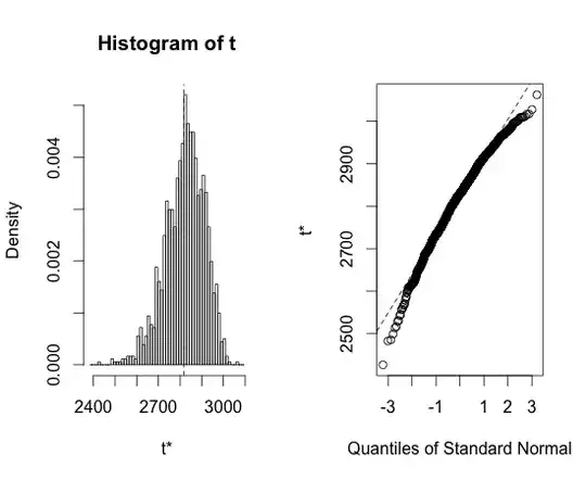

As I learned from the previous question, if the data is approximately Normal, I can use the T-test. Because histogram does not show interesting facts, I bootstrapped the score mean.
What follow are the results of the bootstrap
Bootstrap for the mean
Call:
boot(data = Tol$Tol.Score, statistic = mean.fun, R = 1500, sim = "ordinary")
Bootstrap Statistics :
    original   bias    std. error
t1* 2817.702 4.079778    91.06932
How much am I safe to perform the tests using the T-test? Shall I use a permutation test instead? Other thoughts?

First, with respect to the outlier, I personally would remove it (with the permission of my advisor, of course) - a score of roughly 0 indicates that they couldn't figure out how to play the game, or they just plain hated it, or some other non mood-related factor which completely dominated everything else for that observation.
Second, since you're comparing three means rather than two, or so it seems from your description, you're really looking at an F-test rather than a t-test. A nonparametric alternative to the F test (which assumes Normality as does the t-test), is the Kruskal-Wallis test. It's quite efficient even at the Normal distribution. You might prefer the Jonckheere-Terpstra test, though, which tests against ordered alternatives and therefore would be more powerful given your actual alternative hypothesis.
However, it must be said that the t-test is quite robust with even a smallish sample size, except that outlier of yours would cause problems, no doubt about that.
A permutation test against ordered alternatives would require some care in constructing the test statistic. I'm not so up on my permutation tests as I ought to be, but I'm sure it's been done many times before. Permutation tests are good, no question about it.

  • Thank you, your answer came as I was reading about the Kruskal-Wallis test. Yes, I have three means but I always compare them in two, and always have H0: mean_a = mean_b vs. Ha: mean_a > mean_b. Does your answer still hold? –  Feb 12 '12 at 15:45
  • By comparing two means I do not cover all combinations, that (I think) would imply to compare all three means –  Feb 12 '12 at 15:56
    You can certainly do that, but you need to think about the http://en.wikipedia.org/wiki/Multiple_comparisons problem. Also, your test results won't be independent of each other, e.g., if A > B and B > C, what are the odds that A > C (statistically significantly speaking.) In the pairwise comparison approach, I'd use http://en.wikipedia.org/wiki/Wilcoxon_signed-rank_test, and I'd still toss the outlier, but permutation would be good too. – jbowman Feb 12 '12 at 16:25
