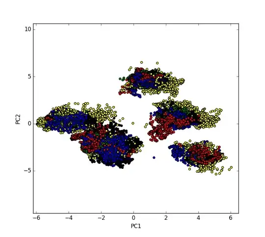

I'm not sure if this will help diagnosis the issue, but I plotted the 2 PCAs that were run on the training set and colored them by which of the 5 groups they belong to.
>>> colors = {'A':'red', 'B':'blue', 'C':'green', 'D':'black','E':'yellow'}
>>> y_train_colors= np.copy(ytrain)
>>> for k, v in colors.iteritems(): y_train_colors[ytrain==k] = v
>>> plt.scatter(x=xtrain_pca[:,0], y=xtrain_pca[:,1], c=y_train_colors.tolist())
5 groups are very clearly being defined by these two PCAs but the colors don't match as I would expect. Any thoughts on where this went awry?

I then run the same code on the human activity recognition dataset. Note that I'm running the this on a slightly different version than I did initially, which is why the scatter plot looks a little different than the one above (also the principal components are plotted in the reverse order).
Nonetheless, as you can see, the PCA does a pretty good job dividing the dataset into 5 target groups (of which there are), but the colors that identify the groups do not indicate that the data is being partitioned correctly. Is this possible?

  • @amoeba, just able to revisit this now. I made a plot of the two PCA's above and it does seem like it was able to distinguish between 5 groups. The colors (and the accuracy when applied in the RF) indicate that this classification was not accurate. I think the PCA must have been able to distinguish correctly and there was an error when applied to the test set? – AJG519 Aug 05 '16 at 21:15
