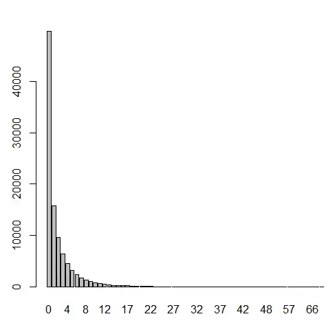

I have fit two models on a count variable.
The first model is based on the assumption that the response variable is Poisson and the other is based on the assumption it is a negative binomial.
The AIC for the model where a Poisson family is assumed is 476497, whereas the AIC for the negative binomial assumption is 339581. Furthermore, the data has a large number of 0s and the mean of the count variable (response) is 1.974 while the variance is 12.86011 breaking the Poisson mean = variance assumption. enter image description here
However, Micheal Friendly's distplot in R suggests the count variable follows a Poisson process. (Micheal Friendly's plot is essentially an equivalent form of the Q-Q plot for discrete data. It is interpreted in an identical manor as a Q-Q plot)
Which distribution should be applied to the glm?Raw count data bar plot
Lastly, I could fit a quasipoisson model but the AIC appears as NA for the model and I do not know any methods of testing a quasipoisson assumption so I do not know how to compare that model with these ones.

    (1) zero-inflated doesn't imply 'false' zeros in any sense. (2) The quasi-poisson doesn't have a fully specified likelihood so no AIC - see Why is the Quasipoisson in glm not treated as a special case of Negative Binomial?. (3) It might help to explain/reference the plots for those unfamiliar with them. (It seems odd that any graphical technique to assess fit, correctly interpreted, would suggest a Poisson's a better fit than a negative binomial, when the former's a special case of the latter.) (4) What about a barplot of the raw data? – Scortchi - Reinstate Monica Jul 29 '16 at 09:10
  • Thank you for the information. I have added the bar plot and explanation of the initial plots. I am having a little trouble understanding " (It seems odd that any graphical technique to assess fit, correctly interpreted, would suggest a Poisson's a better fit than a negative binomial, when the former's a special case of the latter.)" Since this is true, shouldn't setting the link as 'poisson' give identical coefficient estimates to the glm with a 'negative binomial' link? However, they are indeed giving similar estimates. Which glm should I use? – Ali Turab Lotia Jul 29 '16 at 10:58
  • Lastly, Micheal Friendly's plot determines the distribution the response variable follows. It is not a measure of how well the proposed model fits to the data. – Ali Turab Lotia Jul 29 '16 at 11:11
    (1) The Poisson's being a special case of the negative binomial doesn't imply you obtain similar coefficient estimates whichever model you use for a regression - why should it? (2) Don't confuse the link function in a generalized linear model (usually a log links' chosen for Poisson & negative binomial models) with the model family. (3) I didn't pick up that you're regressing on other variables - in that case the marginal distribution of the response is quite irrelevant & you should be looking at residual diagnostics. – Scortchi - Reinstate Monica Jul 29 '16 at 11:29
