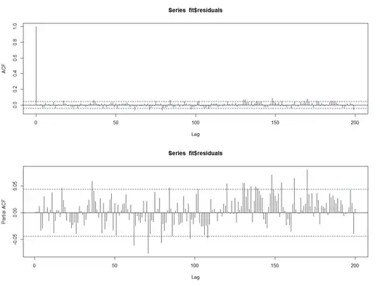

The graphics for serial correlations look OK in my mind (maybe except the PACF in very high lags), as you can see in the graphic below.

Question: How do the results of the Ljung-Box-Pierce test and the plotted ACF match?
I thought most test results should have a $p$-value greater than 0.05 as I saw the ACF. Maybe something is wrong with the degrees of freedom, because of the 91 estimated coefficients in the xreg argument?
I'm sorry, but I'm not allowed to publish data.
