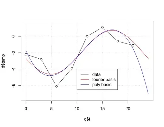

The two fits are shown below, and they are "similar". My question is, what's wrong with the polynomial fit on periodical data? In this case we do not have the extrapolation and the time should always be $[0,23]$
    d = data.frame(t=c(0,3,6,9,12,15,18,21),
    temp=c(-2.2,-2.8,-6.1,-3.9,0,1.1,-0.6,-1.1))
    X=cbind(1,cos(2*pi*d$t/24),sin(2*pi*d$t/24))
    coeff = solve(t(X) %*% X, t(X) %*% d$temp)
    X2=cbind(1,d$t, d$t^2, d$t^3)
    coeff_2 = solve(t(X2) %*% X2, t(X2) %*% d$temp)
    plot(d$t,d$temp,type='b')
    d_new = seq(0,24,0.1)
    X=cbind(1,cos(2*pi*d_new/24),sin(2*pi*d_new/24))
    X2=cbind(1,d_new, d_new^2, d_new^3)
    lines(d_new,X %*% coeff, type='l',col='red')
    lines(d_new,X2 %*% coeff_2, type='l', col='blue')

Discontinuity at $T=0$ and $T=24$ is problem. In fact, the plot is misleading because it only plots $T$ up to $21$. If we change the plot code as:
plot(d$t,d$temp,type='b',xlim=c(0,24),ylim=c(-7.5,1.5))
We can see 3rd order polynomial is not a good fit:
At time $0$, the temperature is $-1.7$, but next day at time $0$ the temperature at $-7.04$ !:
In addition, it is very nature to have function input $T$ as any real number, instead of limited to 0 to 23.
For example, when $T=25$ it just means 1:00 in next day and $T=-1$ means 23:00 in previous day. Using polynomial basis we need to make to inside 0 to 23 to generate output.
But with Fourier basis expansion, everything is build in.
