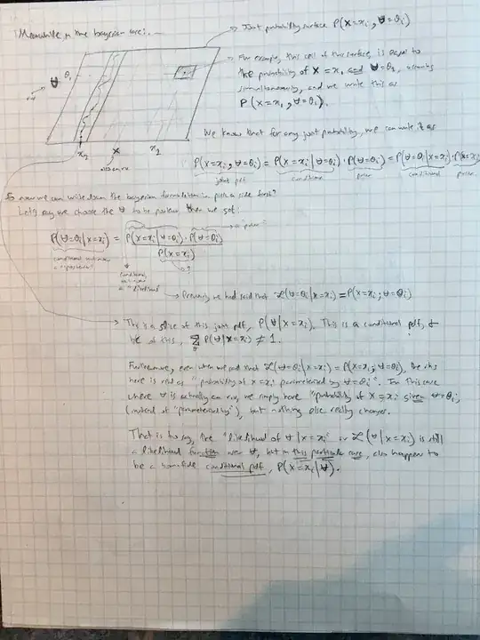

Based on @amoebas answer, I have drawn his last comment. I think it's quite elucidating, and I think it clears up the main contention I was having. (Comments on the image).
EDIT III:
I extended @amoebas comments to the Bayesian case just now as well:

  • (1/2) Amoeba, thanks again: So the picture in my head is taking on this form: In the classical non-bayesian sense, the likelihood $L(\theta|x)$ is not a PDF, (rather, it is a function of $\theta$, given $x$), but it is in fact numerically equal to a probability value, in this case, the probability of $P(X=x; \theta)$. Have I understood this part correctly? – Creatron Jul 19 '16 at 23:39
  • (2/2) However, in the Bayesian setting, the term $P(b|a)$, is a conditional PDF, and the likelihood is in fact equal to this conditional PDF, even though the likelihood is not a PDF in and of itself. Is this correct? I think it is those last points that escape me. – Creatron Jul 19 '16 at 23:41
    @Creatron: What you wrote in (1/2) sounds entirely correct to me. What you wrote in (2/2) is kind of correct, but sounds a bit fuzzy so I will try to clarify it again. The term $P(b|a)$ is a conditional PDF of $b$. Its integral over $b$ must be equal to 1, but its integral over $a$ can be anything. I hope this is clear. Now, when we say that $L(a|b)=P(b|a)$ we start seeing it as a function of $a$. But it is not a PDF of $a$. – amoeba Jul 19 '16 at 23:46
    @Creatron: [cont.] Think of a smooth 2D function with the following property: its integral over $x$ at any value of $y$ is equal to 1. So any horizontal slice (at fixed $y$) is a PDF. Now take the same function but make a vertical slice (at any fixed $x$). The integral of that will not be 1. Horizontal slices are conditional PDFs and vertical slices are likelihoods. Does it make sense? Of course any single point in 2D belongs both to some PDF and to some likelihood, hence the defining equality for the likelihood. (I should probably include this cartoon in my answer.) – amoeba Jul 19 '16 at 23:50
  • Amoeba, I want ahead and drew up what you mentioned in your last comment. I think I get it now… basically, while the likelihood is indeed a function of $\theta$, it is actually composed of actual probabilities themselves, where each probability is $P(\mathbf{X}=x ; \mathbf{\Theta} = \theta$. This was the point I was not getting - yes it’s indeed a function of $\theta$ - but each point - each element - on this function, is ITSELF a probability… do I understand it now?... – Creatron Jul 20 '16 at 03:05
    @Creatron, yes, exactly! I like your drawing :-) Note that one can easily imagine a situation when all horizontal slices are identical, i.e. the PDF $p(x)$ does not depend on $\theta$ at all. Then any vertical cut is going to be a flat line, meaning that the likelihood function $L(\theta)$ is going to be constant (for any value of $x$), i.e. have a diverging integral $\int L(\theta)d\theta = \infty$. This further shows that one can't see it as a PDF, but as a likelihood function it's fine. – amoeba Jul 20 '16 at 11:11
