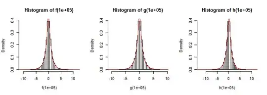

On the plots below you can see distribution of $10^{5}$ samples drawn using each of the functions with accompanying Laplace density (red line).
To simplify the examples I use standard Laplace distribution with scale = 1, but you can easily change the outcomes by multiplying the results using different scaling factor.
