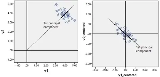

Can these pictures help?
The first 2 pictures are about regression. Centering the data does not alter the slope of regression line, but it makes intercept equal 0.
The pictures below are about PCA. PCA is a regressional model without intercept$^1$. Thus, principal components inevitably come through the origin. If you forget to center your data, the 1st principal component may pierce the cloud not along the main direction of the cloud, and will be (for statistics purposes) misleading.
$^1$ PCA isn't a regression analysis, of course. It however shares formally same linear equation (linear combination) with linear regression. PCA equation is like linear regression equation without intercept - because PCA is a rotation operation.

  • The second example is not correct. PCA is maximizing variance, so in the case of left uncentered data the direction found would be similar to right ("distance" of line from data cloud does not matter). The differences come in higher dimensions, where the data are complex and searching for the optimum direction should then be done from the center of the cloud. –  Aug 27 '12 at 10:47
    PCA is maximizing variance This is not generally true. PCA maximizes (by the 1st PC) sum-of-squared deviations from the origin. Only if the data were preliminary centered (centering itself isn't a part of PCA) it turns to be maximizing variance. – ttnphns Aug 27 '12 at 11:42
    P.S. Note that computation of covariances or correlations implies centering – ttnphns Aug 27 '12 at 11:47
    P.S. Note that computation of covariances or correlations implies centering – ttnphns Aug 27 '12 at 11:47 While I agree with your other comments, both covariance and correlation do NOT imply centering. Neither cor nor covar change value when an additive constant is applied to the data.
    – TPM Oct 30 '14 at 16:13
    @ttnphns: Your second figure (about PCA) has one unfortunate drawback: 1st PC on the centered data is exactly orthogonal to the 1st PC on the un-centered data. As a result, it might make an impression that failing to center will only influence the 1st PC, and all the other principal axes will simply get shifted by one (1st become 2nd, etc.). This is of course not so. If your cloud on the left were rotated e.g. clockwise by 60 degrees (and if you also marked 2nd PCs on both subplots), this would become more obvious. – amoeba Dec 15 '14 at 11:09
  • @amoeba, I could have been selecting better data for the example, but who cares? The truth is there. The "impression" you are talking about indeed might mislead somebody sagacious, like you, but a sagacious, like you, will then certainly get rid of the impression. – ttnphns Dec 15 '14 at 11:45
