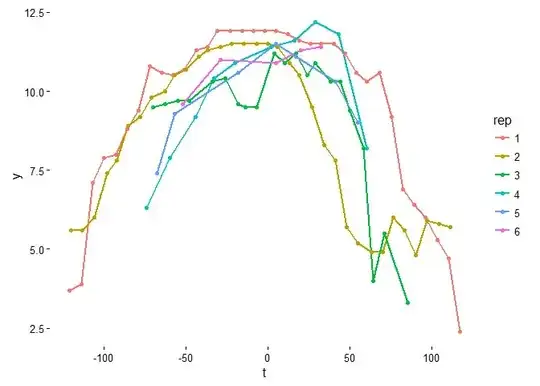

I've inherited observations of a response variable ($y$) measured over time ($t$) during which the response increases and subsequently decreases. The measurement of this response occurs repeatedly over ~ 50 replications ($rep$). The code below pulls in some data from six example $rep$s spanning the range of the replicates. In this case, time $t$ has been centered across all $rep$s but it need not be.
Some complications of the data include, as the figure illustrates, that the response is usually not measured until after is underway and before the decline has concluded. This is especially true in later replicates, which observe a smaller window and make fewer measurements of the response curve (e.g., see $rep$ 6).

Six replicates
