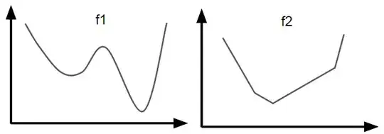

In this example, function 1 is non-convex and smooth, and function 2 is convex and none-smooth. Performing optimization on f2 is much easier than f1. In fact, the loss for least absolute deviations on whole data set is very similar to f2.

  • Maybe you're artistically challenged, but f2 doesn't look convex to me. But yes, with some adjustments, it could be made convex and non-smooth. – Mark L. Stone Jul 06 '16 at 14:27
  • Actually, f2 as (currently) drawn, appears to be quasi-convex, which allows bisection to be used to find the global minimum (within the bisection starting interval). – Mark L. Stone Jul 06 '16 at 14:35
