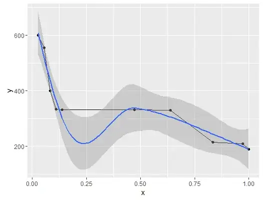

In your case the data are decreasing, which is good. But you also have 4 data points where the ordinate is nearly constant (with respect to the range of y, $I_y =[\min(y),\max(y)]$), even if the corresponding variation in x is considerable, with respect to $I_x = [\min(x),\max(x)]$.In other words, you have a large plateau in the center of your sample:
df <- data.frame(x,y)
library(ggplot2)
(p <- ggplot(data=df,aes(x=x,y=y)) + geom_line()+geom_point()+geom_smooth())
This is not a pattern which can be easily fit by a monotone decreasing third degree polynomial.
