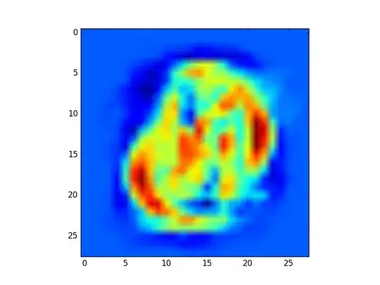

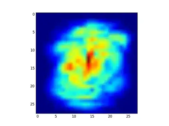

More importantly, in Neural Network updates, the weights corresponding to a 0 in the input are not going to be updated. You can see it experimentally by observing the evolution of the weights of your neural network after training (resp. W_begin and W_end). Below are two heatmaps representing the changes in absolute value of the weights.
from matplotlib.pyplot import imshow
heatmap = (np.abs(W_begin-W_end).max(axis=1)).reshape((28,28))
imshow(heatmap)
For this first image - white on black digits - you can see that the weights haven't changed at all on the image border (dark blue).
mnist_normal1
However on this second image - black on white digits - you can see there is a brighter blue on the border, meaning these weights have changed. But you also notice dark blue regions near the center of the image, which shows that weights haven't much evolved in this area.
mnist_inverted1
Intuitively, we don't care about updating weights at the border because the corresponding pixels do not discriminate the different classes of digits. However, we do care about the weigths in the middle of the image for the opposite reason. This explains why white on black MNIST performs better than black on white.
