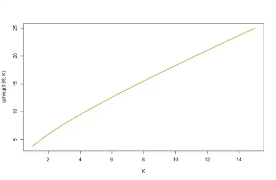

The figure below plots the 0.95%-quantiles of the $\chi^2_K$ distribution as a function of $K$, i.e. the value that the LR statistic needs to exceed to reject the null that $A$ is the "good" model.
As you can see, higher and higher values of the test statistic are needed the larger your set in $B$ that "overfits" the data. So the test suitably makes it more difficult for the (inevitable) better fit (or log-likelihood) of the larger model to be judged "sufficiently" large to reject model $A$.
Of course, for any given application of the test, you might get spurious overfitting that is so "good" that you still falsely reject the null. This "type-I" error is however inherent in any statistical test, and will occur in about 5% of the cases in which the null is true if (like in the figure) we use the 95%-quantiles of the test's null distribution as our critical values.
